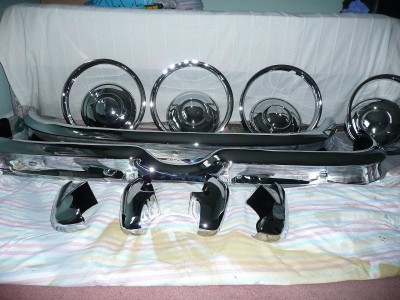

Update on the chroming.
I took all the bits for chroming to 'Prestige Electroplating' of Mexborough on 11th October with completion expected in 4 months.
I got a phone call about a week ago to say it was all done and available to pick up, but due to personal events I couldn't go until today. I took the two bumpers, 4 overriders, 4 hubcaps and 4 rimbellishers that looked very much past their best with a dent in the rear bumper.
What I picked up was brilliant smooth shiny chromed metal, it looks too good to put on a car. I am very pleased with the results as you can see, I found them very pleasant to deal with and would be happy to use them again. Now all I have to do is fit it and protect it for the winter months, but the S type is running again so time is available. All for £920.
Brian

Sorry for the delay in uploading a picture of the chrome, It has been decided to store it in the loft as I don't fancy working in the cold garage at present. So before I put it in the loft and covered the shiny sides with petroleum jelly I took this picture. Also drove the car up and down the road a bit so its not parked on the same part of the tyres.

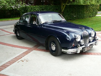

Attached hopefully is the re- chrome bumpers, over riders and hubcaps on my partially resprayed car.
I am very impressed with the chrome, but can see every blemish in my paintwork!
