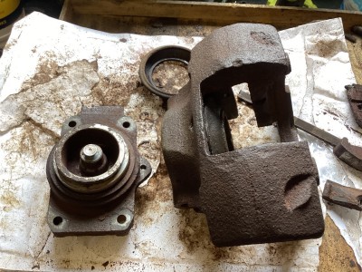

As my front suspension is now off I will in parallel to the bodywork be going through and refurbing all the suspension elements.
I thought I’d start with the callipers….
I have the first one mostly stripped down - although not without woes.
Good news:
the caliper unbolted easily (where easily always means+48hours of plugas)
Cutting all the corroded brake lines at the unions allowed easy removal of the unions
The 4 piston housing bolts came out ok (where ok means some mangled nuts through nut gripper usage)
Bad news:
Both pistons are seized - not unexpected
The pad support securing bolts are fairly mangled and inaccessible
One of the pad supports is broken
Question: my googling skills have let me down, can anyone suggest where I might be able to get replacement pad supports as I suspect I may need a few?
The part numbers are 10097 (VBO.9221). 10098. (VBO.9222) you can see the snapped one and it’s pair with a broken retaining bolt
I was going to take a view on getting them sleeved once I get the pistons out
Not so g
Front Caliper parts 3.8S
