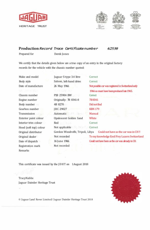

Dears,
I have the above S Type which has been converted from an Automatic to a manual, by whom and when do not know. My question is how can I trace exactly what gearbox and year model mine is from, the number being KBN179. Or indeed what Jag did it come from. Also I attach the Heritage Certificate which I received recently according to the plate on the car. It is annotated with my feedback as clearly my car does not match fully with what is registered, hence why I believe a conversion.

Hi Derek I also have a '66 S which has been converted to manual. The correct gearbox for this is the jaguar all synchro and the serial numbers started at JBN, so at a guess KBN is a continuation of that series. You don't say if yours has overdrive. What's wrong with the box? These boxes aren't cheap to rebuild, and I'm not sure on parts availability, so depending on whether you want originality or improved gearing you could consider a 5 speed conversion. The benefit of an auto conversion is the gearbox tunnel is bigger which means the box can be removed without disturbing the engine.
