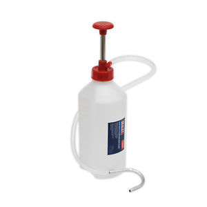

A small hand-operated mini pump like the one below will make short work of it. Costs around £15 online. This one is a Sealey TP6804 1 litre mini pump.
I have a garden pressure sprayer that I've adapted which is fine for things like transmission fluid that flows better but differential oil is much thicker and so it takes longer.
The little pump below pumps directly so will probably be easier for diff oil. You will only need to refill the bottle once as I think the diff takes just over 1.5 litres.
Hope that helps!
Hope that helps!
Re: 420 re-filling Final Drive / IRS with oil
Ah! .... thanks David.... now why didn't I think of that!
