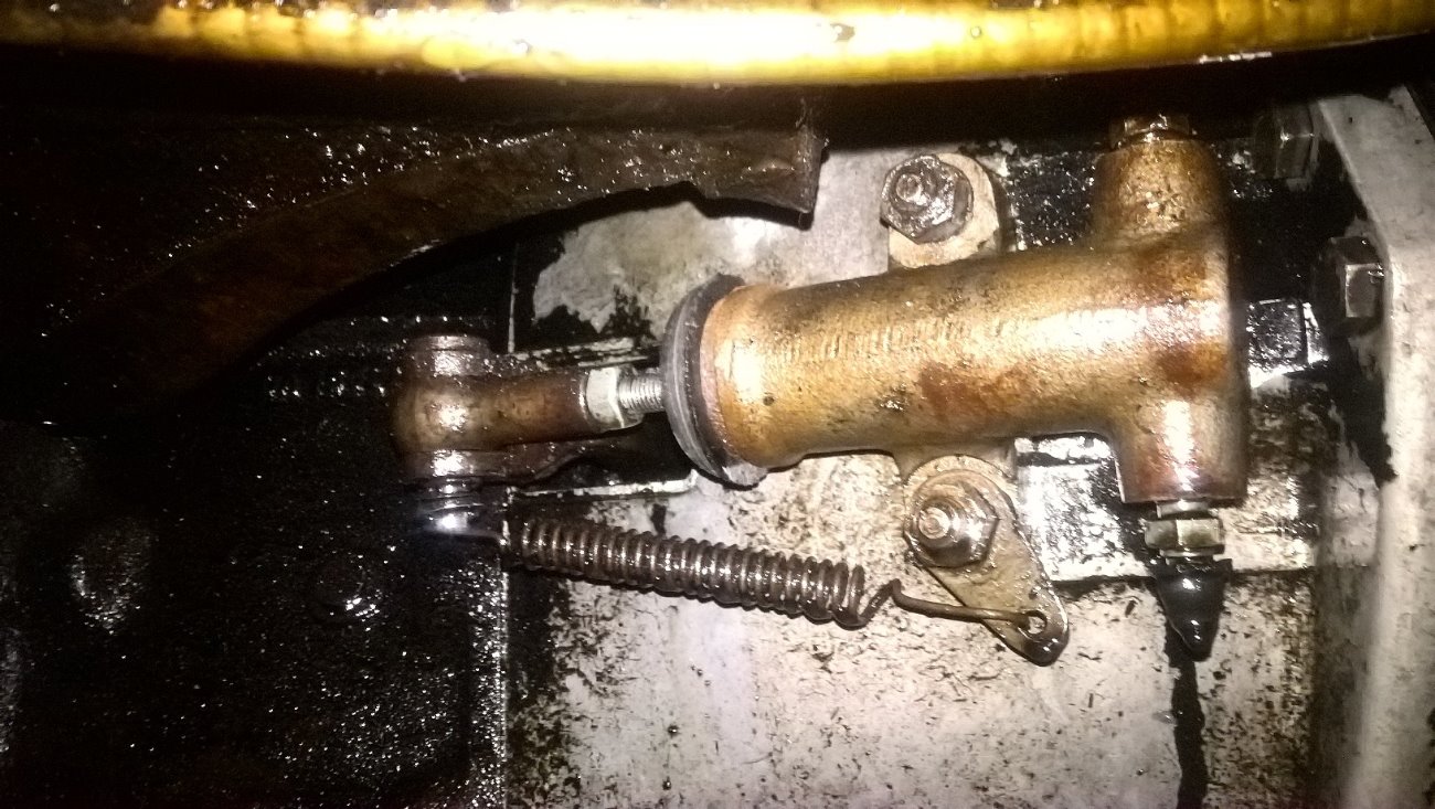

Hi all, Thanks for the replies. I think the slave cylinder is the earlier type as it has the return spring on the outside of the cylinder body. I must admit I didn't make sure the cylinder was clamped in the retracted position before bleeding.
Also the hydraulic pipe enters at the top of the slave cylinder and the bleed nipple is on the bottom. Therefore I think I will have to make a new section of pipe so that it can be fitted into the bottom port with the bleed nipple being fitted onto the top.
I'll try your suggestions and see how I get on this weekend!

Your image of the slave cylinder appears to show the late hydrostatic cylinder with the earlier return spring. In addition, we do not know whether the clutch is the normal multi spring Borg and Beck or the later Diaphragm type. Added to this mix is that the slave cylinder rod changed four times at engine numbers 7B 5212, 7B 6571, 7B 10993 and another carried from 7B 10994 (3.4S numbers). A similar change happened to the adjuster assembly.
The arrangement shown in your image will cause clutch operation issues in any event, and if it ever worked would have clearance difficulties, or the pedal would pick up halfway up its travel, dependant on the push rod. Don’t in any case pump the clutch pedal to effect clutch clearance.These early hydrostatic operations had quite a few problems over a wide raft of vehicles and professionally I came across a few dozen types.
One of the early cars fitted with that hydraulic arrangement was the Mini, it was successful because it had a back stop to prevent the cylinder withdrawing too far. That is exactly what your arrangement requires in any event, a back stop, some would call it an adjuster. When set correctly it will allow setting of the clutch engagement position, clutch clearance and no over stroking of the hydraulics to damage the clutch.

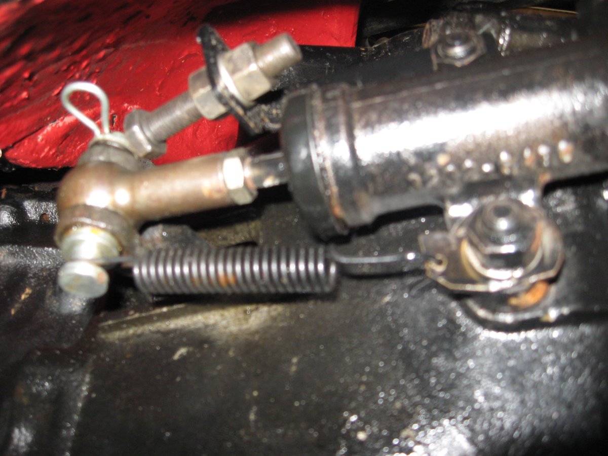

I will try to attach an image showing an experimental back-stop adjuster fitted to a S type with the early multi spring clutch. As the original rod for the earlier cylinder is not suitable for the late cylinder and some of the rods do not seem available it may be that a new rod needs making, or a later rod re-tapping further down the shank.
