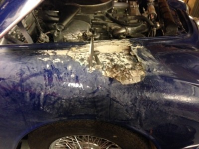

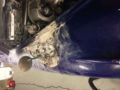

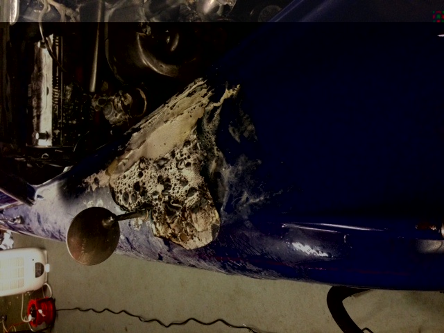

I've put some pictures on below. 'Destroying' front wing may be a bit extreme, paint burnt off is better description. Not entirely convinced new one is necessary., but looks ugly. Bonnet superficially ok - but underside paint bubbling.

I may sound cheeky, but I think you have been very luck. I'm looking at the lines of the enginebay/wing line, the wheel arch line and the curve of the wing line, all look good.
Event the top hose is in one piece and the battery LOOKS intact, but I wouldn't trust it now with heat on the outer casing. Also the wiper motor is near the heat so maybe faulty.
Autosparks have a very good reputation for making wiring looms and will usually make one up including the modifications you require (8 way fusebox, relays etc.).
If it was my car, I would get a new loom made (to suit the engine and later car).
Strip out the dashboard for access.
Send the complete carburrettor set up to Burlen fuels
Get a new battery and fuel filter (It took me ages to stop the filter leaking everywhere).
Get the hydraulics cylinders rebuilt or replaced (possibly cheaper)
Get some new pipes made and fitted if they need doing.
find someone to match and spray the wing and bonnet.
And get it on the road and enjoy the summer.

Re: How to open bonnet if catch cable snaps?
I'm fairly keen to do this myself, but not sure if beyond me (& time always at premium - I've got a 1year old and 3 yr old to play with). Getting engine out certainly won't be a good idea myself (don't have equipment apart from anything). I guess if it comes out would make working on rest much easier for me and allow repainting on inside of wing. But I'd probably send engine off for refurb if I take it out.
Spent hours yesterday trying to clean extinguisher powder out of engine bay. This has now got me worried as clearly very corrosive stuff. Already bringing out rust on non stainless bolts and various components. hard to shift. Desperately hope none in engine, the powder accumulated around spark plugs is a worry.
Starting to creat a job list and look in Haynes (always makes it look easy). May get some quotes, just to see.
Had it booked in for show at Harewood today, that's gonna be depressing going without it!
Hi,
Assuming the engine was running when the extingisher was set off then the big air filter will have stopped most of it. If the engine was stopped then it is even less likely to be in the engine.
It looks horrible but it is only paint and mechanical lumps that can be replaced.
If you were happy with the engine before then there is no need to remove it now. Photograph everything and make drawings and notes as you strip it down. Once you have the bonnet off, air filter and carbs off you will find you have a lot of access to the inner wing to clean and repaint (by hand).
The inlets to the carbs will tell you how far the powder got, also it is an old engine, no cats or lambdas to worry about. Once you have the powder off the outside of the engine and enginebay you can use a big spanner to turn the engine over by hand to keep everything oiled and free.
Brian
Brian
The engine was off when extinguisher went off so as you say unlikely to have got through. It is in the air intake beyond the filter but this is because rubber connector had a hole burnt in it.
Engine was sweet as the proverbial nut before so i have no burning desire to pull it apart if it can be avoided. The brake cylinder etc look a bit tricky to get to but I'm not scared of some grazed knuckles. I'll get carb assembly off photograph and get in touch with Burlen fuels. Maybe get the loom ordered ASAP too.
Need to stop dwelling and get fixing.
Thanks again
Adam
Thanks again
Adam
