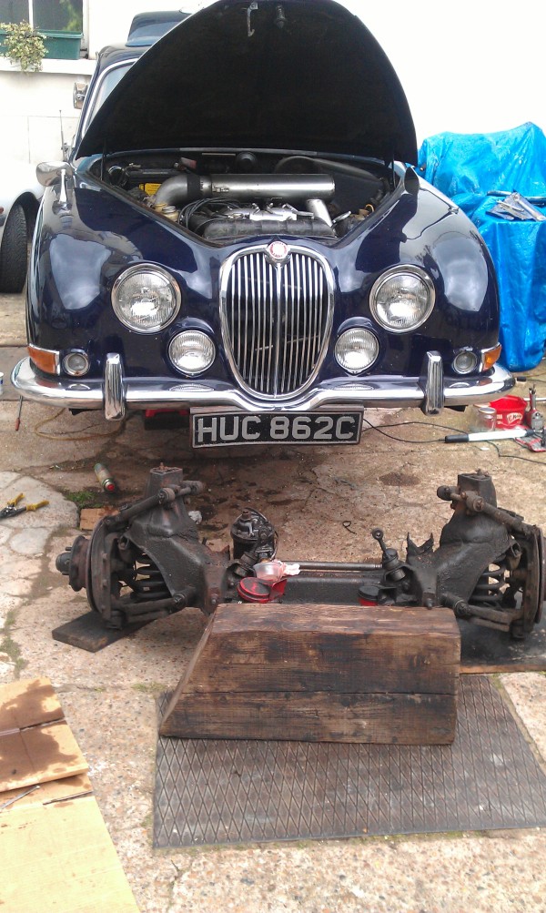

The sump can be removed once the front suspension beam has been also removed.
This is not as big an operation as it may seem - it also gives you a chance to renew the suspension rubbers, change the brake fluid etc.
The biggest challenge is likely to be disconnecting the flexible brake hoses. Beware the beam and springs are a fair old weight - it will take two people to lift it once you've got it lowered to the floor. I did this on my own. I just couldn't lift it once I'd got it out!

It's not as big a lump as the engine is!
It was easy, just needed a decent trolley jack - couple of hours work at the most and that was solo.
Putting it back was simple enough with an assistant.
