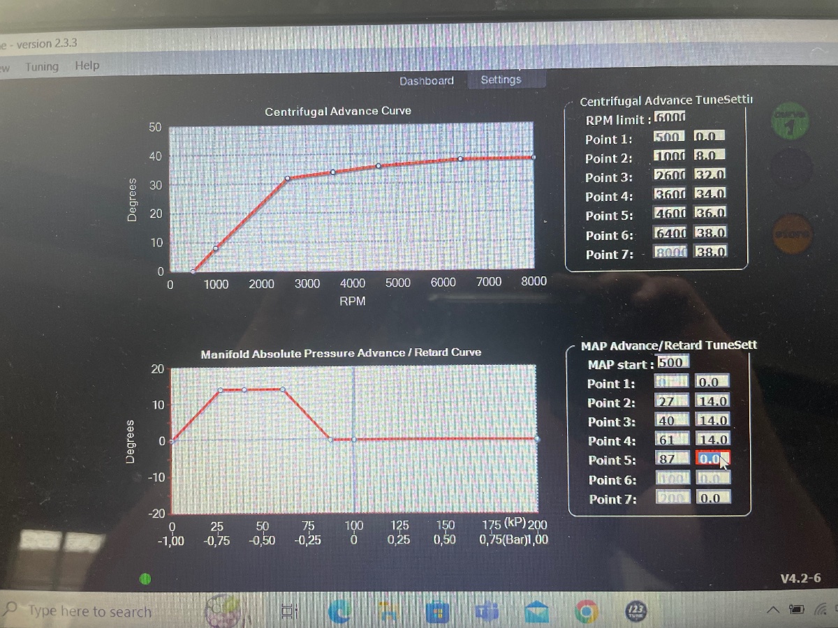

Hi again!
I have now purchased the 123 usb distributor and set the curves based on the original distributor. I have set the static to 10 degrees. I think the distributor centrifugal advance is correct but I’m a bit unsure about the curve of the vacuum advance. A bit of conversion needed as 123 deal in Kpascals and the vacuum advance I guess is in inhg.
So I figured based on the vacuum unit of 8/18/7 (7x2)14 degrees advance at 61 kpascals = 18inhg. The start would be 8inhg = 27 kpascals. Just not sure of the curve from 8 to 18 inhg, is it all in straight away? I’m not sure I have represented this correctly in the attached 123 image.
A second opinion would be much appreciated! I’m not sure the vacuum is set right.
Does anybody have any curves that they can share for reference?
