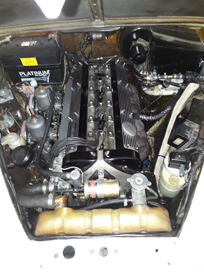

Hello all - new member here from North Wilts, with my 3rd "Jag" but my first classic "Jag" a Daimler V8 2.5 from 1966. I've run classics for 30 years - including 2 MGs (Midget and BGT), a Scimitar, a Rover p6. Generally I do all the work myself apart from major / heavy jobs.
I've had this car as long as it takes for oil to trickle from the tappet chest back into the sump. Overall its in great condition and drives beautifully HOWEVER......
On my prolonged journey home - longer than the quick test drive before buying - I've heard a subtle sound which is muttering the words "big ends" into my psyche. That and the oil pressure dropping to 20psi when hot, sometimes momentarily dipping lower on tickover. Dammit!
So my questions - is this the type of engine where the big end is an immediate issue where I could lose a con rod through the side of the engine, or is it something where I can enjoy the car for a bit before its taken off road?
Is it the kind of job that can be done on these engines just by dropping the sump off in situ?
Can anybody recommend a jaguar specialist or engineering specialist in the North Wilts / Gloucestershire / Oxfordshire area who would be worth speaking to?
Obviously I've just emptied my account on this rather lovely motor, and ain't got a lot to spend now!!
All the best
Chris
