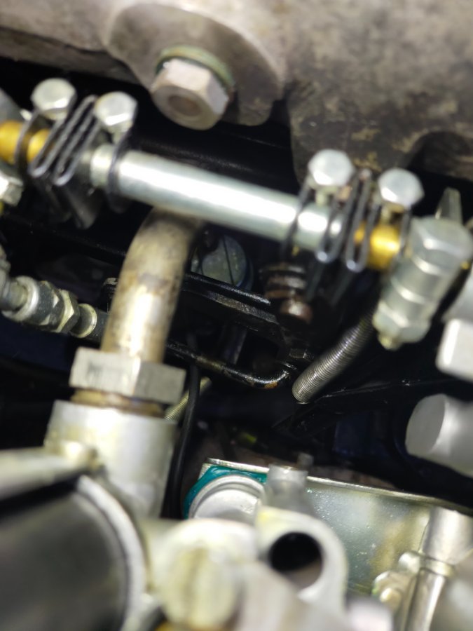

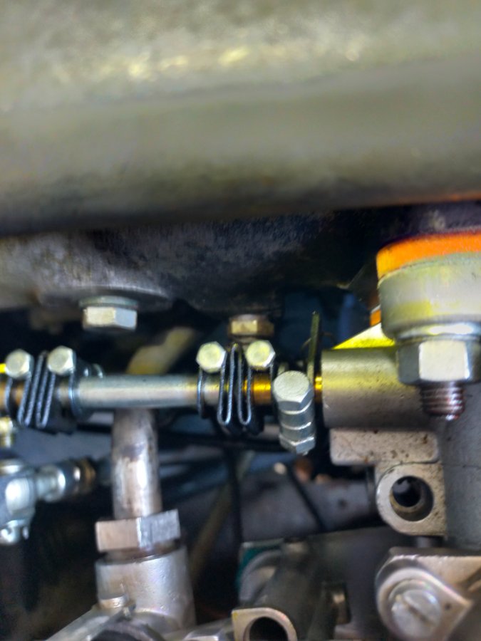

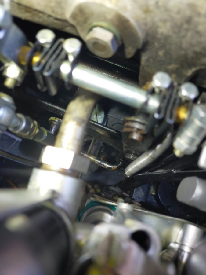

I still have issue. Took another look at the carb linkage. The front carb has a spring that is a failsafe to ensure that the butterfly returns in the event that the connecting linkage comes loose. Well thats what Im assuming..
This front carb return spring seems to be fowling on other parts of linkage. Maybe its supposed to be routed this way but if someone could post a picture of their own front carb return spring I might have found the issue.
I have posted a couple of pics of this
