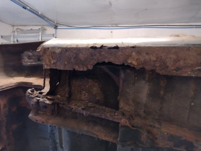

I am making progress now with my rebuild and the shell is currently away being sand blasted and epoxy primed after all the welding has been done. A couple of pictures during that work, typical MK 2 rust.
Alec
