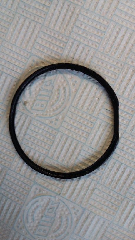

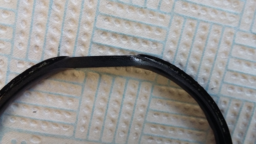

I just did a oil change on my MK2 3.4 , it has the up pointing filter , right pain in the A-- to change , I had a oil drip , so made sure the seal was sat in the groove 100 % , time will tell if I still have a drip , as you can see from the pictures , the old seal was not seated 100% , if it is still only a drip I can live with that , after all its a Jag right ,
Problem is you can't see once the filter housing is bolted down , very poor design
