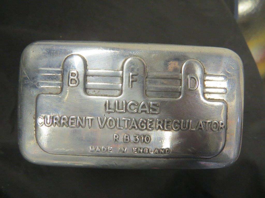

Now the bit i'm struggling with is the wiring. i want to remove the old lucas regulator box and wire it to the new Alternators regulator which i understand is relatively easy, but i need to know which wires i link up and to where? it was also suggested that i run an additional wire from the alternator to the start solenoid as its generating a lot more amps than the old dynamo would have. Grateful to hear from anyone who's done this or knows how to do this.

the best way is to get a wiring diagram from a car that uses the alternator you have bought. It's not one I am familiar with, I assume it has it's own built in regulator. Most of the old regulator wiring can be removed but you will probably need the wire from the warning light and connect that to the alternator.
Other things that need looking at as there is a change of polarity, the battery leads may need to be replaced or remade due to the lengths of the cables. Swap the polarity of the coil, it will work as it is but the spark will be weaker. Check your fuel pump as it may have a diode for spark supression and that is polarity sensitive, I think you would need to buy a new diode (Burlen fuel services) for negative earth. The radio, if you use one will need changing for negative earth.

thanks for this, i have already converted it to negative earth so that parts sorted (with the help of posts from the forum). What i need to know is which wires on the old regulator need to be connected up so that it works as you are right the new alternator has a built in regulator. The existing wires to the dynamo will attach to the alternator in the same way i understand, but i have seen mention that it would be advisable to run an additional wire from the alternator to the starter solenoid?

As has been previously stated you don't need any of the wires from the existing regulator. You will need to keep the wire for the "charging/ignition" light on the dash but you may have to rewire one end of it either to ground or to ignition; the alternator looks like the output marked "D" is for this, but this depends on whether the D pin provides a 12V source for zero charge or expects to pull current through to lamp to ground. As alec says, best to check the wiring diagram for the car the alternator is designed for.
An extra (thick) wire from the alternator positive output (looks like it's marked "B") to the starter solenoid is a good idea as this will already have a thick cable to the battery (just don't bolt it on the starter motor side of the solenoid!). Also make sure you have a good thick braided strap from the engine to the body and from the alternator to the engine (looks as though it has a separate neg terminal rather than return through the alternator body).
