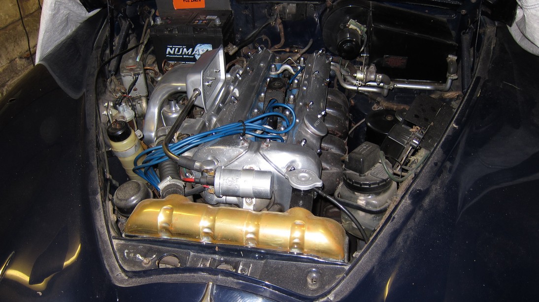

Things that I know that need looking at are:
The old points fuel pump
Leaking carb (possibly fuel jet is stuck)
Previously jammed clutch pedal now freed with brute force
Loose ignition switch in dashboard

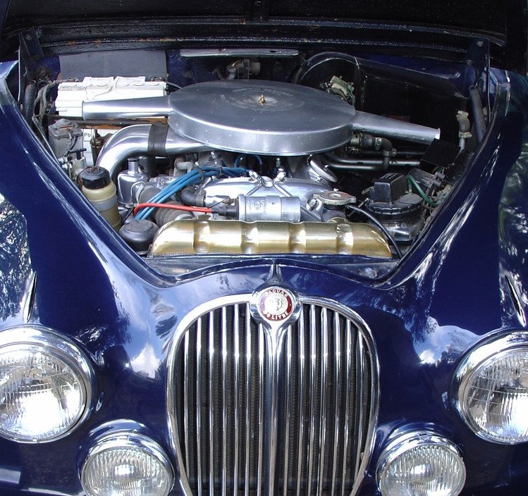

He took the old air filter off and built his own one (photo is of old one)
Plus all the other things that could go wrong after 16 years of not moving/engine running.
What can club members suggest may also need attention after this time?
Externally, the engine bay looks pretty good and the inside looks like new.

Hi, looks in very good general condition from the pictures. However after 16 years of non use then anything rubber (including tyres and bushes) need a good dose of looking at and change if in doubt (tyres especially should be considered for change after this time period, as you can live with a hose going if you are keeping your eye out but a tyre blowing out is a different matter.
Then all structural steel, brakes (driving and trying for effect, this will test servo and sticking/pulling etc) including operation of handbrake.
I found with mine when it was resurrected that most things seemed Ok and looked good from outside (hoses, window rubbers etc) but then found they had perished inside by there being no water in cooling system for instance and leaks when it rained around front window seal. Luckily water pump seal worked fine.
Oil needs changing as should brake/clutch fluid. You may be lucky with no sediment in fuel tank or lines but I put an extra fuel filter in the engine bay before the proper one and it had to be changed a couple of times!.
It does depend on whether it has been used at all really or just sat there dead. If not used then regreasing all joints with grease nipples would do no harm.
It sounds a lot but an experienced person should be able to do most of these things quite quickly if familiar with this type of car.
Other more minor things like screen washer pump can seize if not used. Just keep your eye on gauges and general noises for a while when used, hopefully it will be a pleasure to use.
Best of luck with its re-awakening. Let us know how you are getting on.

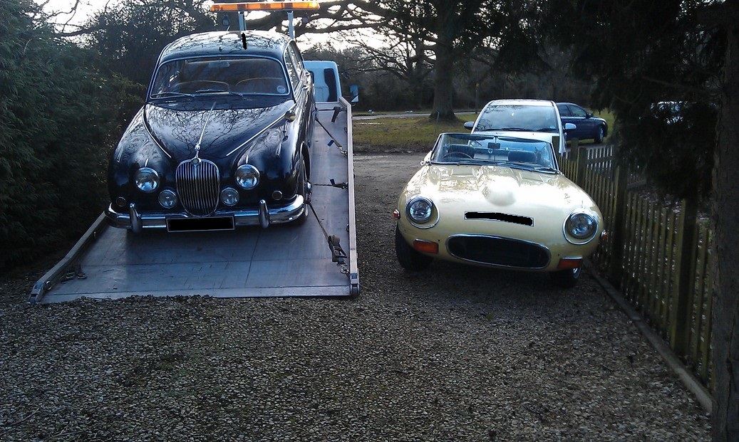

Photo of the modified (DIY) air intake:

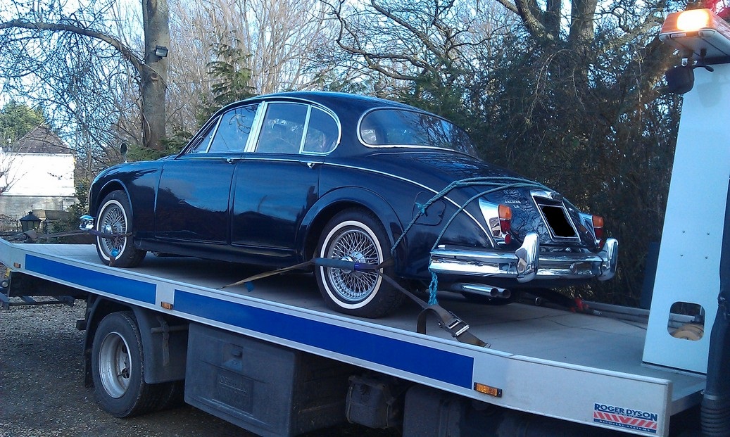

Photo of the low loader:

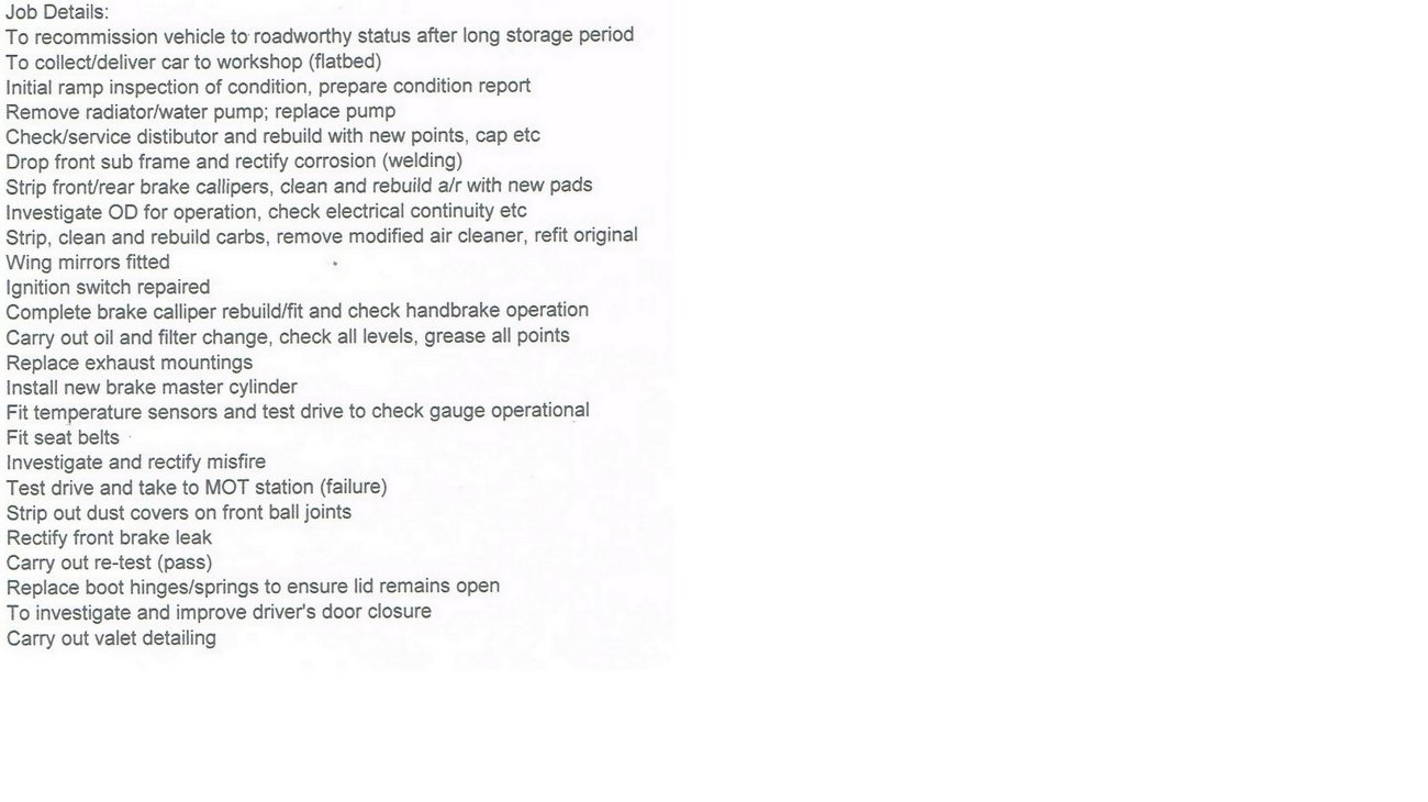

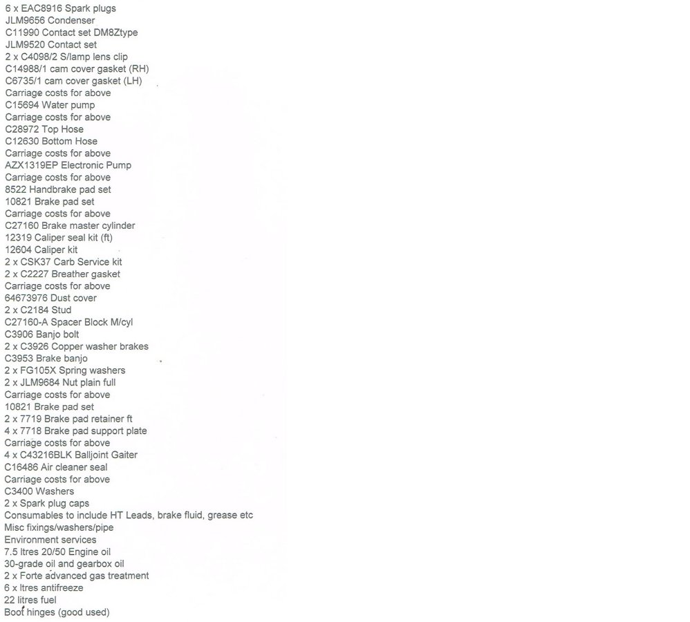

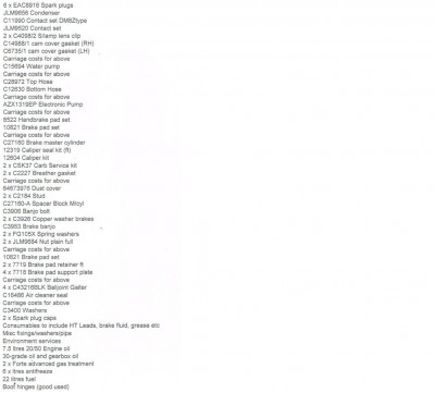

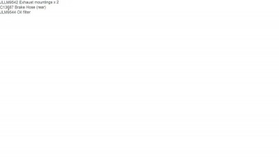

Work done by garage using 71.5 hours labour includes:
plus new electronic fuel pump
