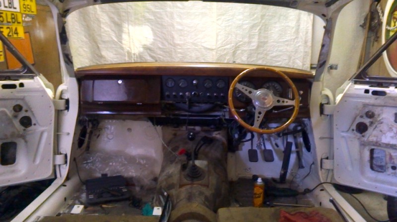

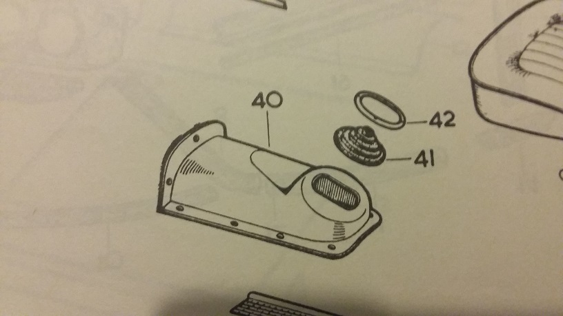

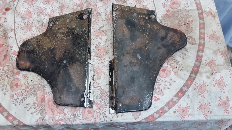

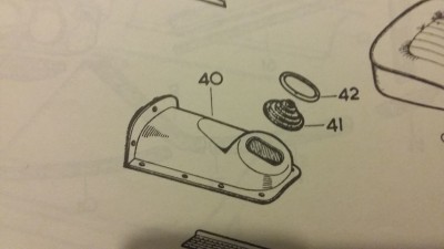

I have done the conversation , but it was a long time a go , my 240 Auto is now a 3.4 manual overdrive , I scraped a 240 manual and stripped it of all the parts , the transmission tunnel is wider on the Auto as said, and taller on a manual , so your have to cut out the top of the Auto tunnel , so the gear selector and stick will fit , manual cars have a different shape tunnel ,so you cant use the panel that bolt's on the manual on the Auto,I think the prop is different too , a tape measure will find that out once fitted , I think I had a little trouble with the Centre console as well , the sides are different at the front end , making the 2 panels that bolt to it different as well
Wires will need sorting , but a good wiring diagram will show that ,
Carpets will be a different shape !
I found a pic that shows the Tunnel , give you some idea what you need to do !
