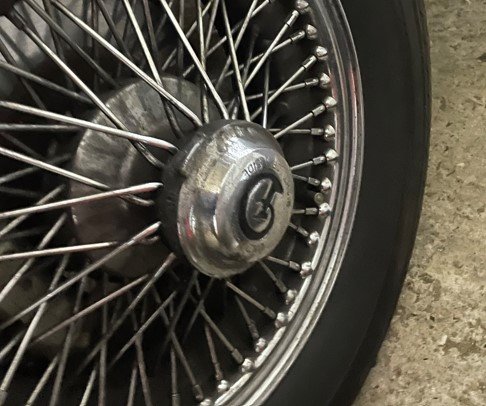

On my 420 Sovereign I’ve got wire wheels with ‘Continental’ spinners. I’ve got an adaptor that I use to take them off and put them back on – with brute force (and ignorance!)
I’m looking for ideas on how to complete this using a more ‘engineering’ method, perhaps with an adaptor that has a long-arm lever attachment or even using a torque wrench.
I wondered if any members have been down this route with these types of spinners and if so, have they any (sensible) ideas or suggestions?

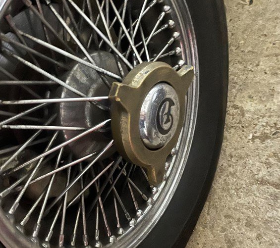

If the brass tool didn’t have a whole in the centre it could of been made with a hex in the middle to fit a long bar torque wrench.
I think all the brass tools to fit the spinners are based on originals to use a mallet. Hence it’s a bit crude.
Modern standards are rather exact and probably why it feels wrong to simply knock the thing round with a mallet.

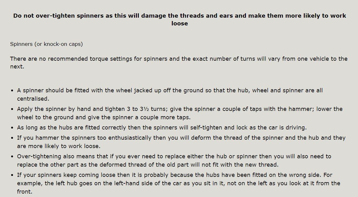

I found this on the MWS website, it makes a lot of sense and it seems I’m worrying about nothing.
It also seems I’ve been doing it slightly wrong over the last 40-odd years.
