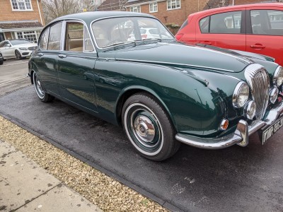

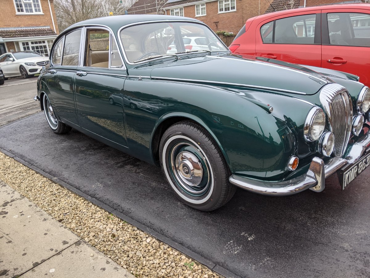

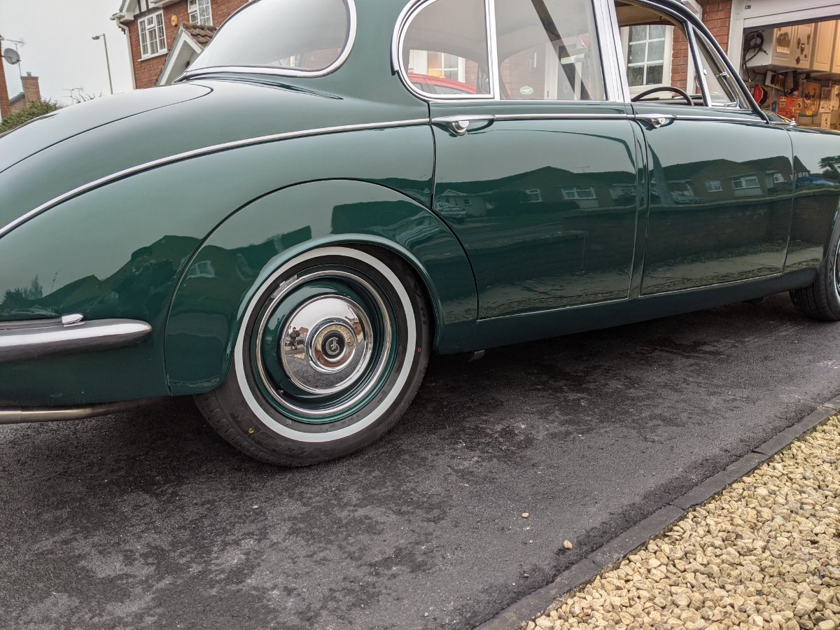

Hi, I need to replace aging tyres on steel wheels, Daimler V8 250. The existing tyres are marked as tubeless but the valve stems hint at being tubed. Will the replacement tyres need tubes fitted. I have bought some old MK 2 steel wheels to stand the car on while I sort out the existing, and by looking at the valves on those they appear to be Tubless. Fitting 185/80-15

Tubless now fitted
