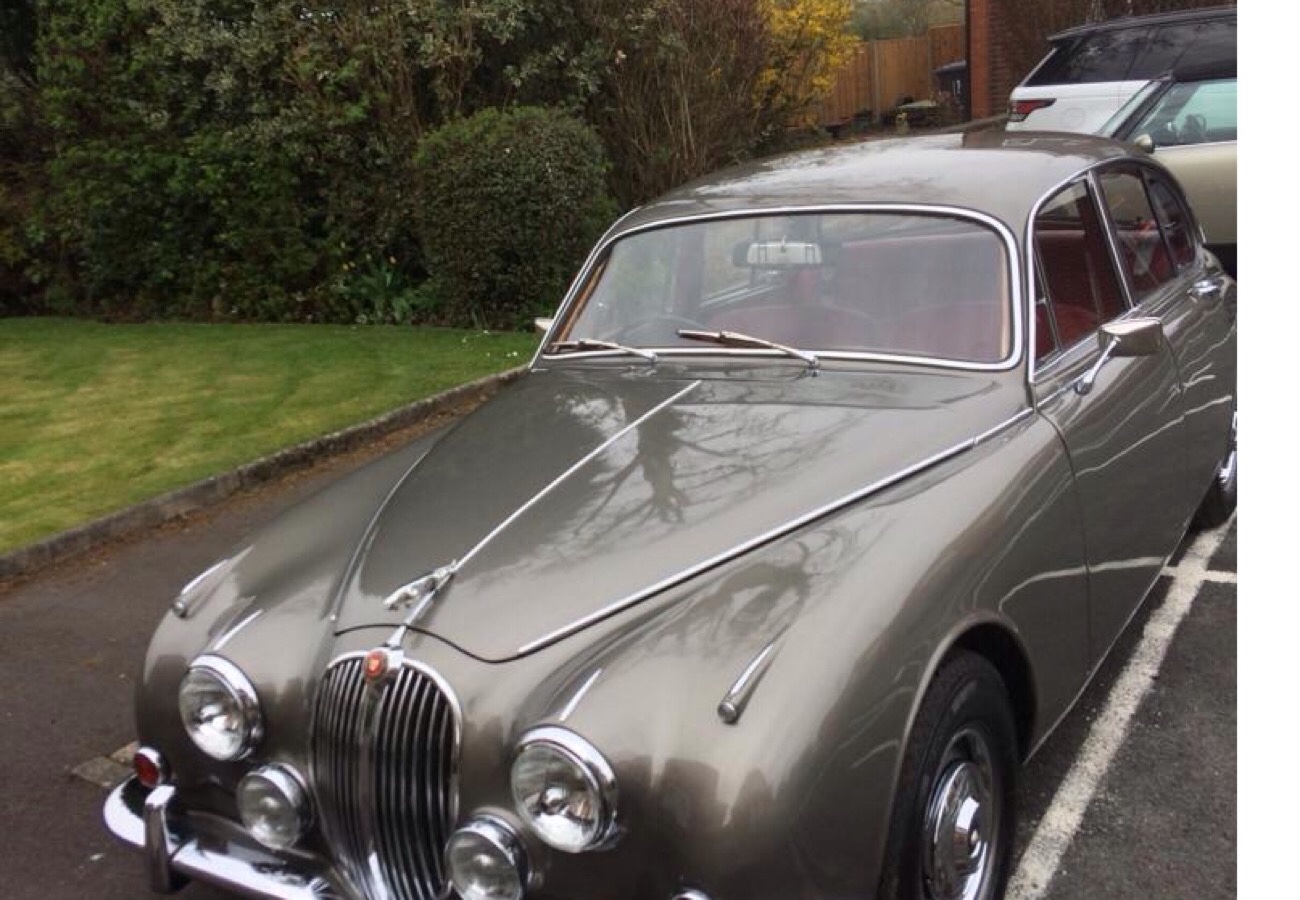

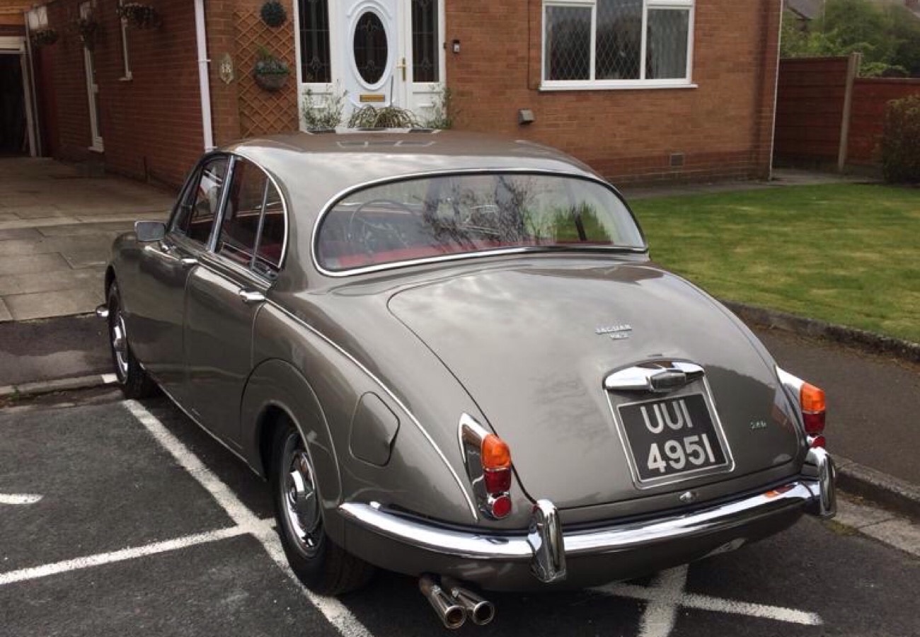

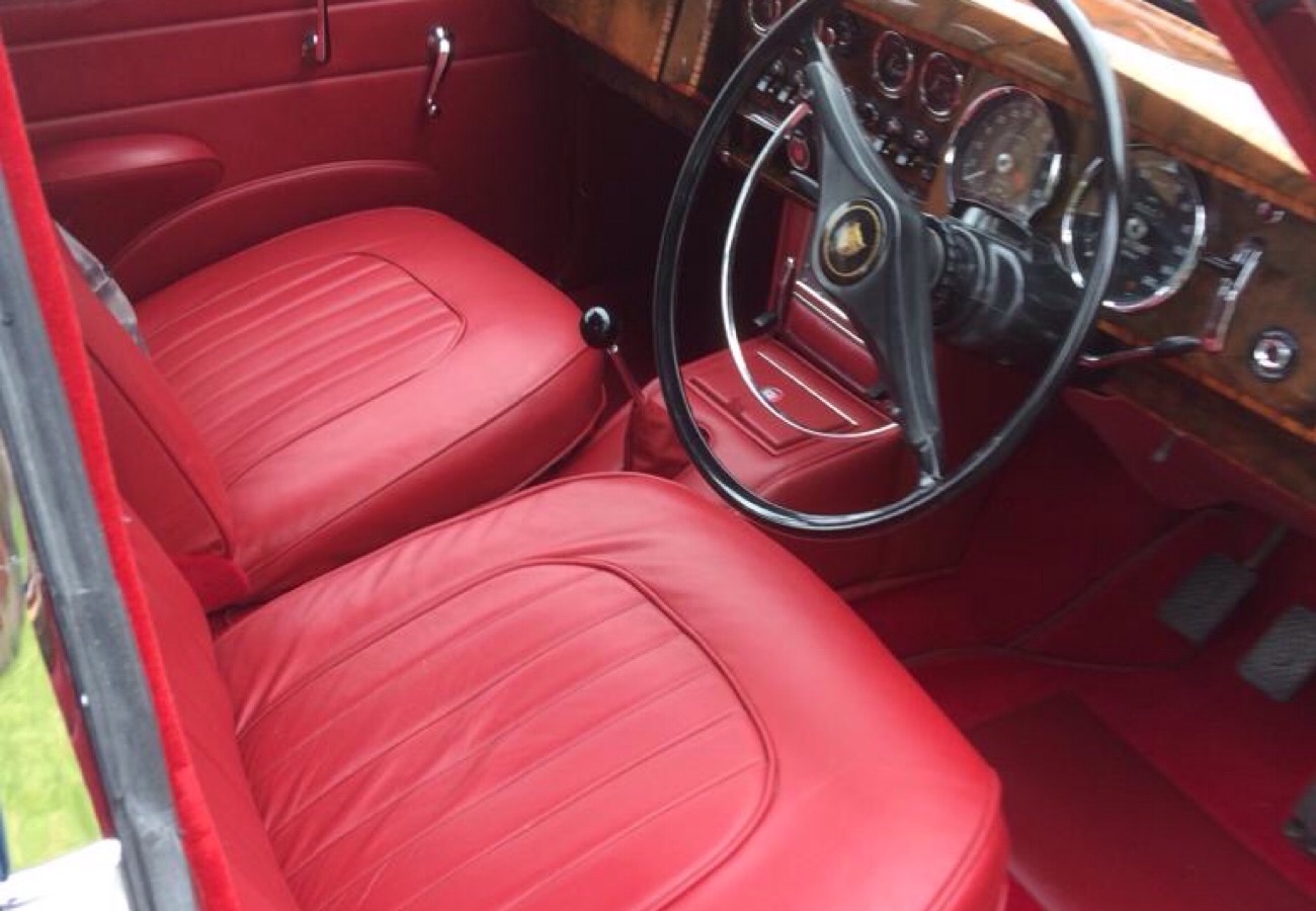

After three and a half years, much support from this forum and members of the Manchester JEC regional group, and of course ebay, I have finally transformed an abandoned 1968 Mk2 240 project into something I am quite proud of. Unfortunately though, as I am sure effects all of us, I am only allowed to look at the results of my labour in the garage for now. Along with a complete refurbishment of everything on the car, a complete rebuild of the engine necessitates a 500 mile run in period before we can begin to enjoy her, which I am itching to complete. Unfortunately I will have to be content with completing the list of jobs in the house which have been neglected over the last three years, at least I should end up in the good books of HTSBO. ( Her that shall be obeyed ) Stay home, the sooner we get this done the sooner we can get back on the road. I look forward to catching up with and meeting fellow members hopefully later in the year.
Moderator MK note to poster. I`ve removed the duplicate images to tidy your thread. What a beautiful job you have done on your car. Quite superb. Well done. I can appreciate your frustration in not being able to use the car during this period of virus lockdown. Look forward to the future. Mike K
