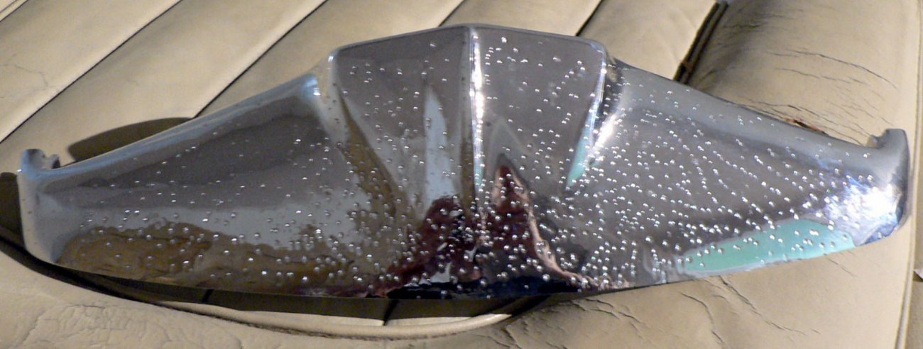

Here's a boot lid light shroud from a Mk IX that I've had up on eBay for the past year or so at a silly price
https://www.ebay.co.uk/itm/Jaguar-Mk-VI ... 3790239302
It was put into the re-chromers in a really bad state. To be fair, they did try to take out much of the pitting that was on it, but this was the best they could do and it ended up like this. Unless you've got only one or two marks that you can pass off as "patina", it really doesn't pay to try a rescue something that's badly corroded, no matter how keen the re-chromers are. And that mazak is a horrid "metal"
Lens edge on, it doesn't look as bad. But bad it still is

Thank you for your valued feedback. Looks like a lot of mazak was used for the small parts, with the real metal left for the bumpers and front grill. I will re chrome these and the rest I will replace.
Thank you again for your insights. Much appreciated.
