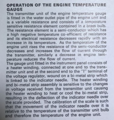

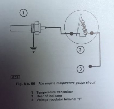

And for info to others, in case you find yourself in this situation, I’ll also share what I found out.
The sender itself is a semi-conductor that responds to heat. As it warms up, its electrical resistance reduces, thus increasing the voltage of the circuit. Below is an extract from the manual that explains it.
Also, a retired engineer told me how to test the sender.
Remove the wire from the sender, turn on the ignition and touch the wire (briefly) to earth – done far easier with help from someone to watch the gauge. If the needle moves, it’s the sender – or in my case a duff electrical connection between the wire/sender due to corrosion.
Sorted! Mine was just a duff electrical connection. I cleaned both the male and female connectors on the wire/sender unit under the inlet manifold, reconnected the wire, let the engine warm up and now the gauge works.
That saved me a considerable amount of unnecessary work!
