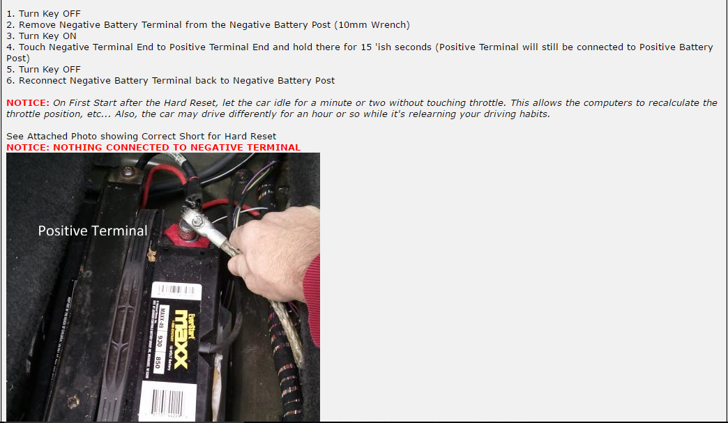

Hi Mark,How do I do a hard reset by the way. I might as well try it.
Thanks again.
Here is info on doing a Hard Re-Set:
Make Sure You Have Your Radio Code Once you have disconnected the negative terminal you have effectively broken the circuit so no risk of electric shock.
Here's a bit more info to clarify:
You have to have a COMPLETE circuit for power to flow. If the negative(or pos) is unhooked from the battery you can touch the DISCONNECTED negative to the STILL CONNECTED(or visa/versa) Positive. There is not a complete circuit and no power flows. you can disconnect both if you feel more comfortable, but its not necessary, it just takes more time. The reason I and others say disc the negative is 2 reasons
1) it is usually the closest and easiest to access.
2) there is usually little or nothing else attached to it.
The reason it works on the capacitors is THEY still have a complete circuit on the car so you are giving their positive terminal a path to ground to discharge them. And since the ignition provides a mechanical link to circuits that are isolated. You can/should also switch the key to the on position while the battery is unhooked and hard reboot again. Then shut off the key and go back and reconnect the battery.
Hope you get it sorted
Take care.
