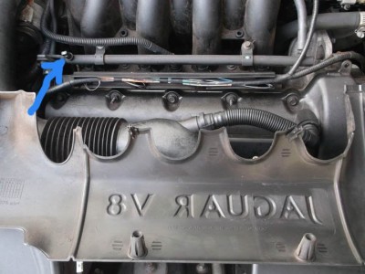

To change fuel pump it's usually drop down rear chassis plate then remove fuel tank as both pump and filter are inboard of the tank
You can check whether your getting fuel up by undoing the Schrader valve in the fuel pipeline.
Tyre air valve tool needed -- it's underneath the black screw on plastic cap
